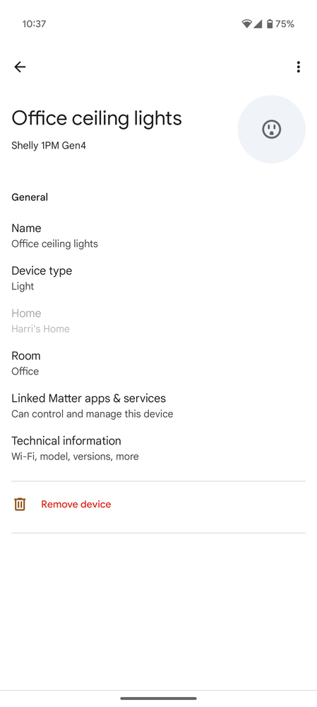

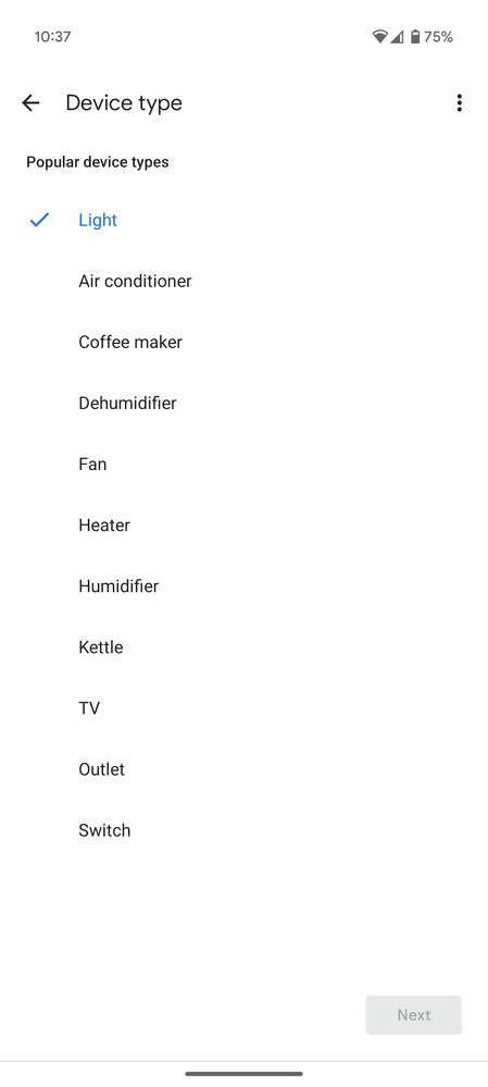

To anyone interested, the issue has fixed itself for me:
1) The device got automatically categorised as a light in the Google Home app
2) The Google Home app now also has a selection for the type of device in the Settings menu of the device (see the screenshots)
