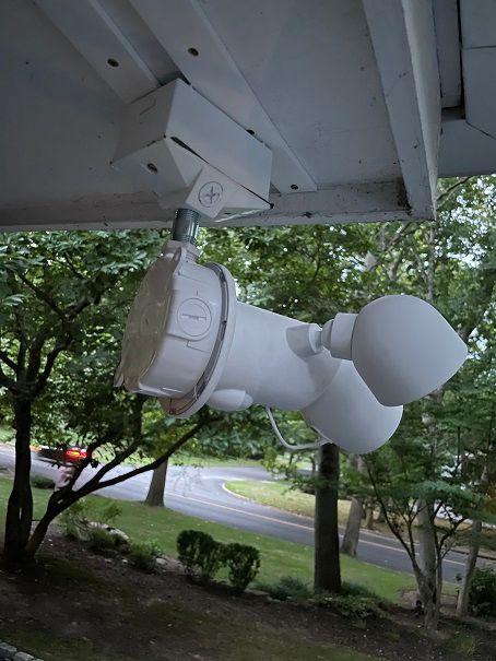

I haven't done it yet, but I think I'll do this.
1.  Mount an exterior box horizontally.    Plug all holes.  Cap with matching electrical box cover with threaded hole in the center.
2.  Screw in a threaded nipple, vertically, through that cover.  (Has to be long enough so floodlights will clear the 'ceiling'... later.).   Affix locknut fitting inside box; tighten.
3.  Thread a round exterior electrical box onto the nipple, this time connecting to the side of the box, so now the box is vertical, hanging by the nipple.  Affix locknut fitting inside box; tighten so that the vertical box faces the correct direction. Plug all remaining holes.
4.  Mount the floodlight onto this vertically hanging box.
I should be doing this soon, so I'll try to post photos when done.

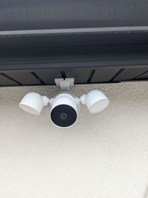

After searching up and down and trying to get my hands on a 3D printed solution, someone tossed out the idea in a Best Buy Q&A of using a wall mount for a dome security camera turned 90 degrees.  The specific one I purchased (linked below) worked well for my situation.  I did not have a round junction box, my previous light was mounted directly to my soffit.  But, there are a handful of options if you search for dome camera wall mounts, and with some slight adjustments, I think this would work for most situations.
The circumference and screw patterns are slightly different from a traditional round junction box, but it works.  You have to turn the mounting plate one arrow from center, and then I used the bolt holes at the 12 o'clock and 4 o'clock positions.  My lights are now horizontal and very stable.
https://www.amazon.com/gp/product/B07L8KJZK5/ref=ppx_yo_dt_b_asin_title_o00_s00?ie=UTF8&th=1

EdG10
Now it's mounted on a vertical box.
