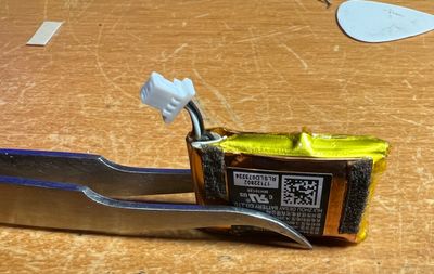

A bit of searching later, I found that there is a lithium battery in the "wired" doorbell that is critical to it working. We all know batteries fail and apparently Google feels that you should just spend more money and buy a whole new unit when theirs fails out of warranty.
I did say Great a few times already, right?
So, I found a replacement battery (from a reputable electronics supplier, which is a hard thing to do with odd sized lithium batteries) and ordered it.  When it came, I took apart the doorbell (not hard, but not easy either) and found that the old battery had not only failed, but was swollen just like one of those batteries which is about to catch fire.
Umm... great.. I think... again??
I immediately brought the defective battery outside to a sand-filled steel container I have for just such situations. Swollen lithium ion batteries are *nothing* to be trifled with.  I'm saving this one for further action on my part, but if anyone reading this ever has a product with a lithium ion battery like that, don't leave it in your office, or especially your house. It's extremely dangerous.
So, new battery installed, peeling front cover re-taped and done. It's "fixed," back on my house (for now,) and covered in a silicon sleeve to hide the ugly front.  Ick.

Swollen BatterySwollen BatteryPeeling DoorbellPeeling Doorbell
