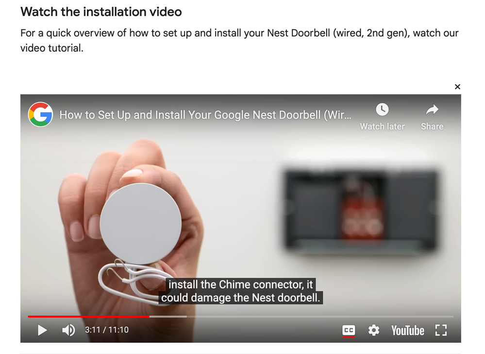

If they've demonstrated that the "chime puck" does not work, how can they refuse to replace it? Google Nest says "If you don't install the Chime connector, it could damage the Nest doorbell."
https://support.google.com/googlenest/answer/12570869?hl=en
They haven't refused (yet), they just haven't initiated the replacement after two weeks of support calls.  In my opinion, I believe this issue is wide-spread and appears to be only affecting Gen 2 doorbells.  I've seen other posts on here where customers were issued the Gen 1 Chime puck, which resolved the issue.
