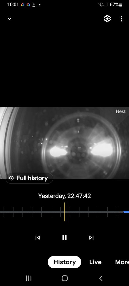

I am using two Nest Cam (Indoor) cameras.  Instead of using outdoor cameras, I am using these two cameras from the inside of the house, looking outside. Both cameras are giving fantastic video and audio during the day. When it gets dark, the Nest Cam on the first floor continues to give  great quality video, even without night vision.
However, the Nest Cam I got downstairs to watch the front entrance is going dark. All it is showing is the reflection of the Nest Cam on the window! (Please see the attached screenshot).
What could be the solution? Is it to do with the level of lighting outside the front entrance?
I will continue to use the Indoor Nest Cam in this manner as I could still study any intruders or movements in to our house. The device is still good at detecting motion and vehicles. It is the video quality that is awful.

The photo does show some sort of visible light reflecting. Will assume you have the latest Google Nest Cam Indoor 2nd Gen. It turns on red lights either side of lens for IR you'll see only at night. Might want to double check IR is really off. Also lower the top green LED brightness to lowest level from Google Home app (You won't be able to turn this off completely)
Place the camera lens right into the window so it is touching.
I've had good results from placing an indoor camera right up against a double glaze patio glass door, then have external PIR floodlight and  external IR emitter. Then turning off nightvision, as the outside IR emitter is much better than IR on camera.
If I had to do it all again though I would probably fit a outdoor camera instead, so it's more visible as deterrent. I want burglars to see I have a camera high up and not hide it as this will imply I have internal security to put them off.
Orange colour in feed - Sounds like amber outside lighting i.e. public street lights. During day is it still orange.
But yeah I have existing electrical wiring outside, but if you have no electrical wiring outside then you'll want to get an electrician fit outdoor wired one high up and they may need to drill hole through PVC/Aluminium/Wooden frame of window/door to pass it through outside then weather proof it. You will get best results this way.

IR emitter is reflecting from the window when indoors.
2 solutions if you want to keep camera indoors facing through a window.
1. Fit a PIR floodlight externally. Means complete darkness until floodlight activates and motion detection will work fine through glass. 4000 lumens is enough brightness for most gardens.
or
2. Fit an IR illuminator externally, which is more discrete as it provides invisible ambient light for camera. Will work better than IR on camera itself.
Both cases you would disable night vision on camera and rely on one of the above (or maybe both)

What you are seeing is common among all of these type of security cams not just nest.  Your best bet (as the other user here said) is to turn off the "nightvision" in the setting and make sure your outside area is well lit.
Of course the best solution would be to get an outdoor camera.  That being said,  I have put the nest 'indoor' cameras outside and as long as they are under cover and protected from rain the work just fine.

Open Google Home app
Tap on one camera to open it full view
Tap cogwheel icon top right corner
Select Video
It's called "Status Light Brightness". You can lower it to reduce reflective when it is facing against window.

Quick update: I turned off the night vision. And I have been good video streams even through the dark nights.

After turning off 'Night Vision,' all my Nest Cams (Indoor, 2nd Gen) are working well. I am getting good quality videos when it is dark outside.
