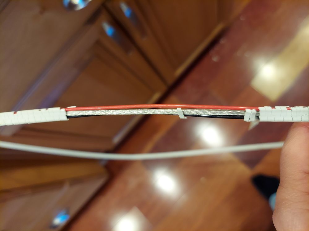

I have a pair of Nest Cams mounted on the house - they're 5 years old.  The wire sheath from the USB->Cam half of the cord has totally disintegrated.  For a product that is marketed as outdoor -- and certainly for a security camera -- this seems like a major quality issue.  I understand that these things can't be warrantied forever but at the same time, if the tires fell off of my car after 5 years I think I'd be looking for a recall.  Google Nest really cut corners here with the construction.  I'm disappointed.

Looks like ultraviolet damage. Was the cable in direct sunlight?
shouldn't matter.  it is rated for outdoor use.  the sun shines outside.
It was in partial sunlight.  As Jimmy said, this is rated for outdoor use.. there is no reason for it to disintegrate like that.  The other half of the cabling from USB -> AC adapter is just fine because it has a proper jacket.

Yes the camera is rated for outdoors and weather exposure but I doubt the cable is. The jacket material is not that durable and sunlight exposure will take its toll.  Proper installation should include wire loom if the exposed length is excessive, like a foot or more.  A couple inches exposed with the camera mounted under an eve will not deteriorate that bad in 5 years IMO and experience. The pic posted above shows more than a couple inches having been exposed, and after 5 years...its no surprise it looks like it does.
Take it for what its worth. Though I say what I did based on personal experience and knowledge.
