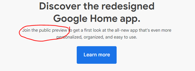

I just received an e-mail about the new Google Home app. It sure doesn't look like what I have currently installed on my Pixel 2 (I know my Pixel is unsupported). Has anyone updated to this? Does it fix anything related to these issues?
I think this got posted to the wrong topic, but I think I can help anyway...
Was this at the top of the email that you are referring to?
If so, I believe the new app is currently in preview mode only. You have to go into the app and request to join the preview and then it will display the new app.
Eventually it will be available to everyone.
