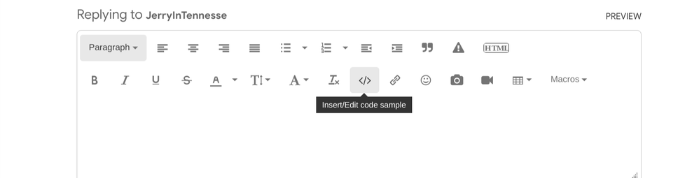

Hi again,
Can you please share your full automation using the 'code' forum option.
