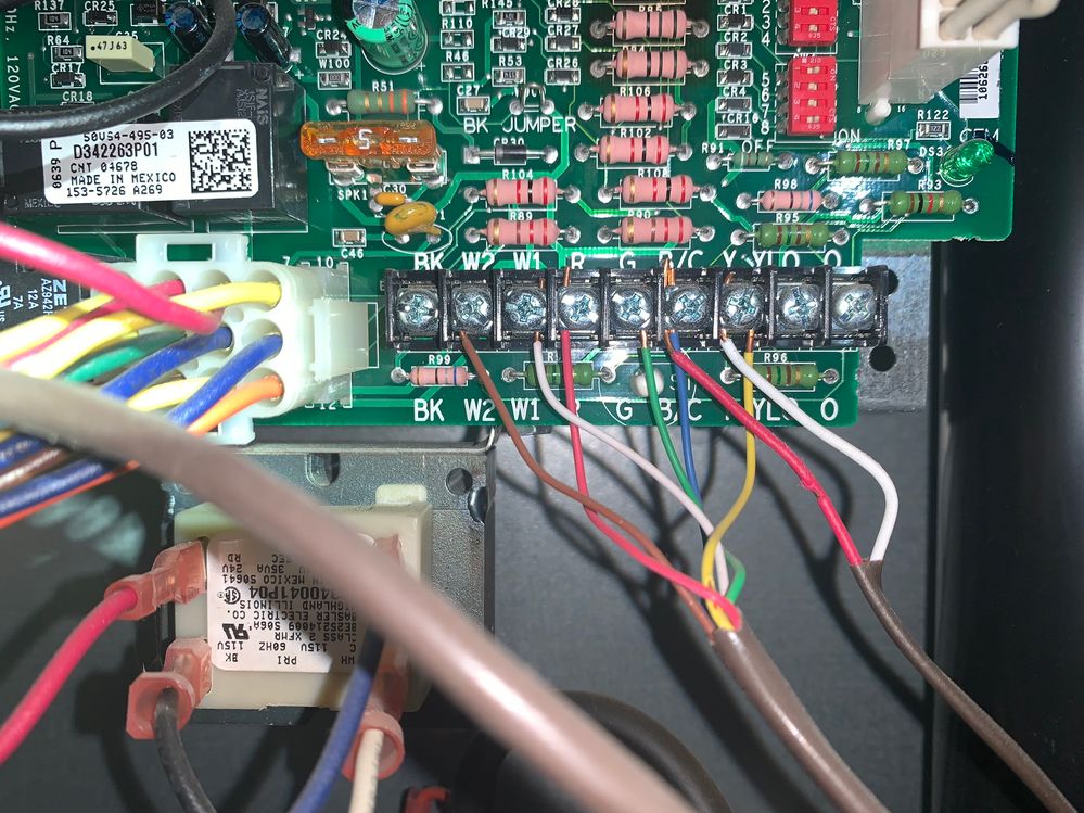

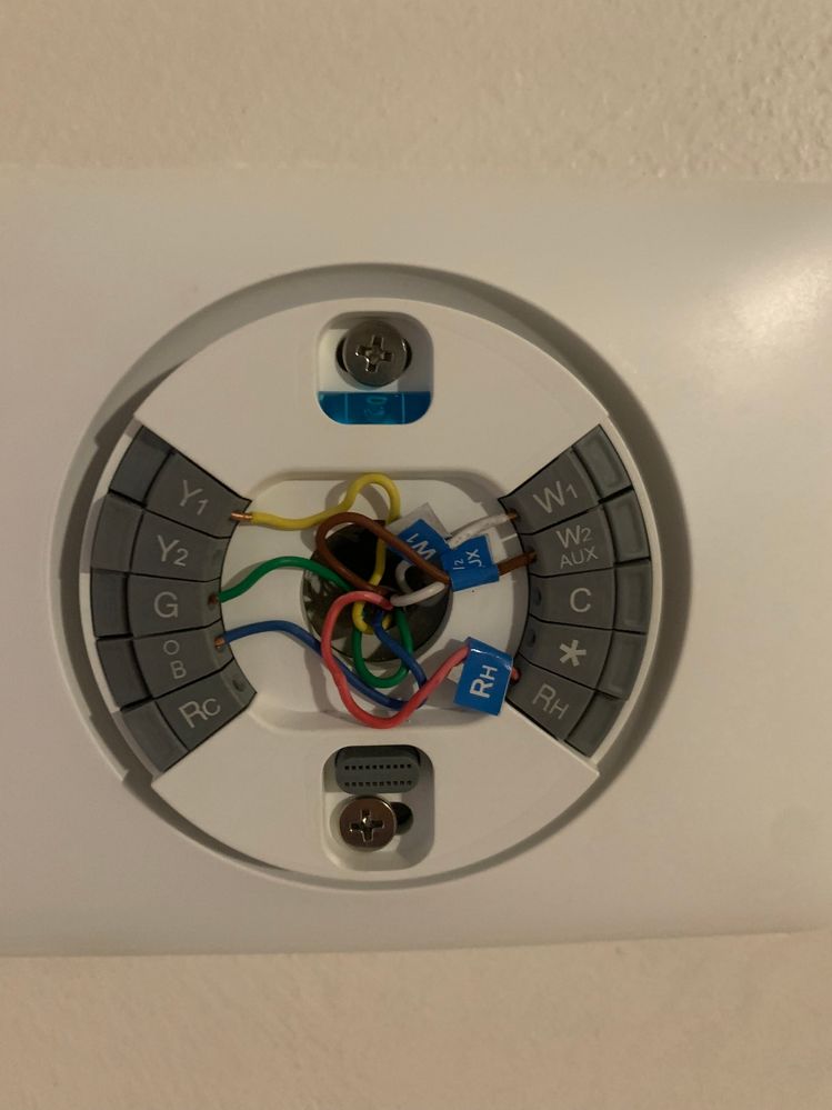

I just installed a Nest Learning thermostat today and got frustrated that I couldn't find a definitive answer with respect to my 'blue' wire. I went to the actual furnace controller (as suggested in the installation guide) and saw that the blue wire is labeled 'B/C' on the controller. (There is no 'C' anywhere.). Installation guide said to wire the blue into the "O/B" terminal on the NEST, but when I did that, the A/C unit would cycle on/off for about a minute and was 'clicking' when it was on. After about 1.5 hours (+?) I looked at the thermostat and it was flashing a little red LED at the top and no display was possible. Looked at NEST app on my iPhone and it said "Thermostat doesn't have enough power for Wi-Fi." I know before I removed the old thermostat, the 'blue'/'red' combo gave me ~27VAC, so I'm *really* wondering if I should move the blue wire from the 'O/B' NEST terminal to the 'C' terminal.

FWIW, here is a picture of the current NEST wiring and a picture of the furnace controller ...Current NEST wiring
Furnace Controller Wiring

NVM. I moved the blue wire into the 'C' (NEST) terminal (after spending a LOT of time reading various threads and info in the guide) and clicking of the A/C stopped and the battery started charging and got above 3.8, after which the Wi-Fi connection was re-established and everything seems to be working. <fingers crossed>
Thought I'd post the 'answer' in case someone else was experiencing something similar. FWIW, the furnace is an American Standard Freedom90 COMFORT-R.
