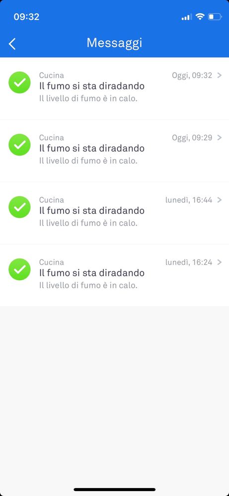

vai0l0
the notification seems to be lagging.
If out of the blue a smoke warning is triggered, no notification is send.
If after several hour a fire alarm is triggered, the notification is sent, after that the clear smoke alert is sent and if I try another smoke waring it's sent.
Seems like the smoke warning does not wake up the wifi but I believe it's essential as the fire will likely start with a smoke warning.
vai0l0
As you can see the order of alarm is not complete,
the first local warning was not reported (it warned me for a couple of seconds before sending a smoke alarm.
when the fire alarm was silenced, the notificatino were not sent via push but only visible in app
I'm able to trigger at will  with an e-cigarett.
