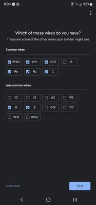

When asked by the Google Home app to select the wires that you have, select these,
R, W/W1, Y/Y1, G/G1, O, C
Example screen shot
