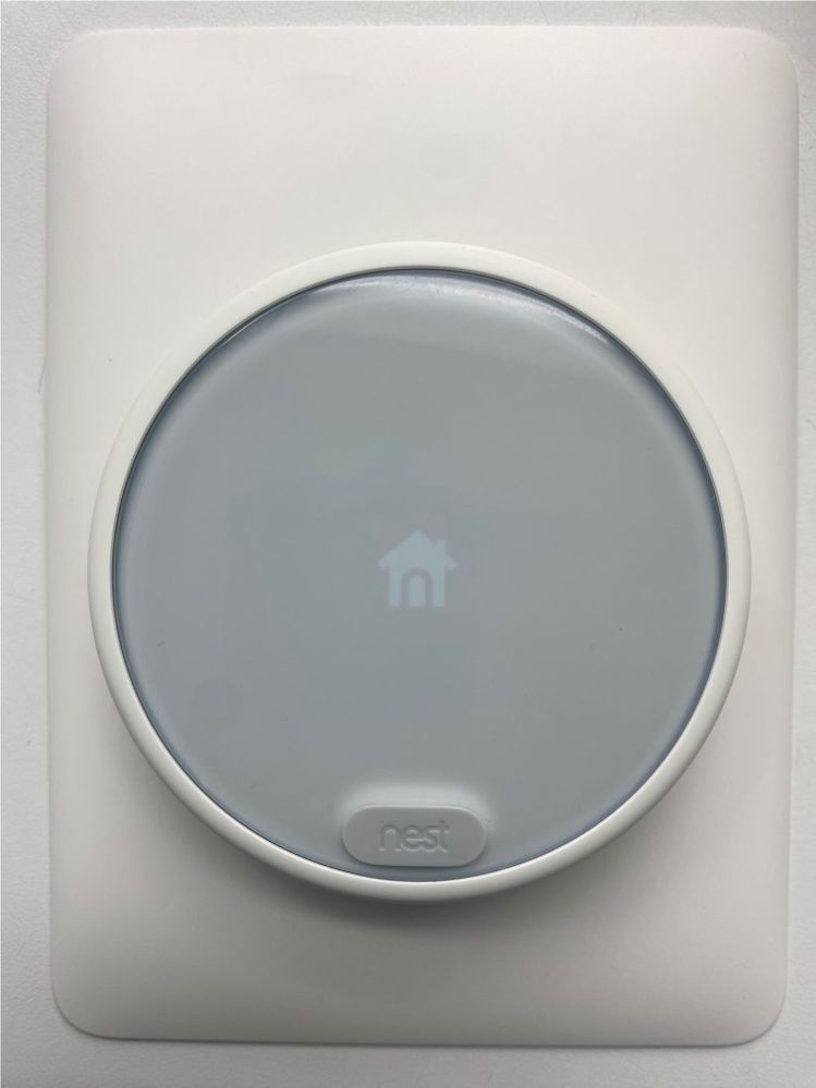

I bought a Nest Thermostat E some years ago, but never opened the box.  Recently opened the box, charged the display via micro USB, installed base (5 wire: Y,G,R,W,C) but when I put the display on the base I get the same issue as @Underpar  "The display shows the house icon, sometimes it flashes green and then flashes orange, then the thermostat reboots and keeps doing this over and over" (from Nest E is constantly rebooting during install - Google Nest Community
Even tried letting battery die (leaving display off base for some hours) then mounting the display: in this case it flashes red light for a while (recharging) then goes back to the behavior above
As stated by user @Underpar  "It seems to be stuck. Therefore, I haven't proceeded far enough along to add the thermostat in the app."
Any suggestions to move past the house icon?   Any advice greatly appreciated 🙂
only thing on the screen other than flashing green/orange lightsonly thing on the screen other than flashing green/orange lights

Can you reset the sucker?
Also tried factory reset (although it was never setup) still stuck in a rebooting mode

Hi Manuel, those steps do not help me 🙁
I also tried another troubleshooting method:
  • at another house, removed an already wired, working Nest Thermostat E
  • installed the faulty thermostat
  • red light flashed for a while (while it charged)
  • then it started (as in screen capture in first post)
  • but again it is stuck in a continuous reboot loop
Any other suggestions?  Obviously I am not the only person with the same issue
Please advise, thank you, lomaxiii

lomaxiii
Someone from Google contacted me.  We went through multiple additional troubleshooting steps, but did not find a solution and I was advised to purchase a new thermostat (since the device was "new in the box" but purchased multiple years ago, the warranty is expired :()
