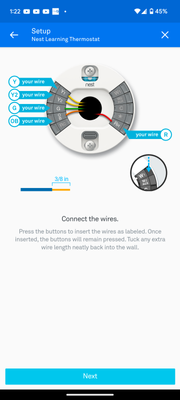

According to the details, I can see we have no problems connecting the wiring configuration to our Nest Thermostat. Here is an example with the Nest learning thermostat:

I already purchased the learning thermostat.  I installed it, and guessed on the setup and tested it.  For the heat tests, it only blew cool air.  I didn't try the heat tests, but when I exited testing, the thermostat called for ac, but the heat came on, so I swapped back to the old thermostat.  Looking at the diagram you provided, all the wires were the same except the app had me connect the red wire to Rh.  This did not seem correct since my original setup was R and RC with a jumper.  That must be why heating and cooling were reversed.  I'll try again tomorrow.
JW54
 i restarted installation on the nest app and this time selected R and Rc, but the app still instructs me to use Rh.  Also, to the question asking if I have a heat pump, I answered 'don't know ' and based on my o/b wire being white, it advised me to continue with standard labels (not heat pump).
JW54
I installed the thermostat again using your suggested wiring diagram, switching from Rh to Rc.  For whatever reason, heating and cooling are still reversed.  I read online that when this happens, switching the O wire setting to B will fix this, and it did.  It is now cooling fine.  Can't test heating since it is so hot in Texas right now.
