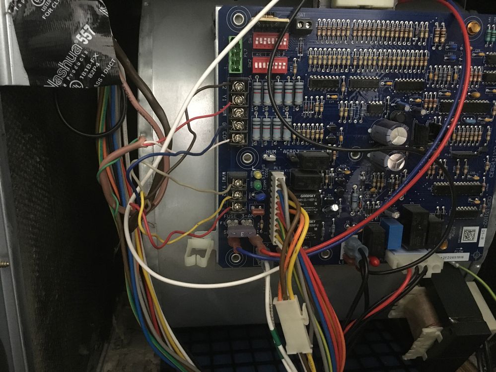

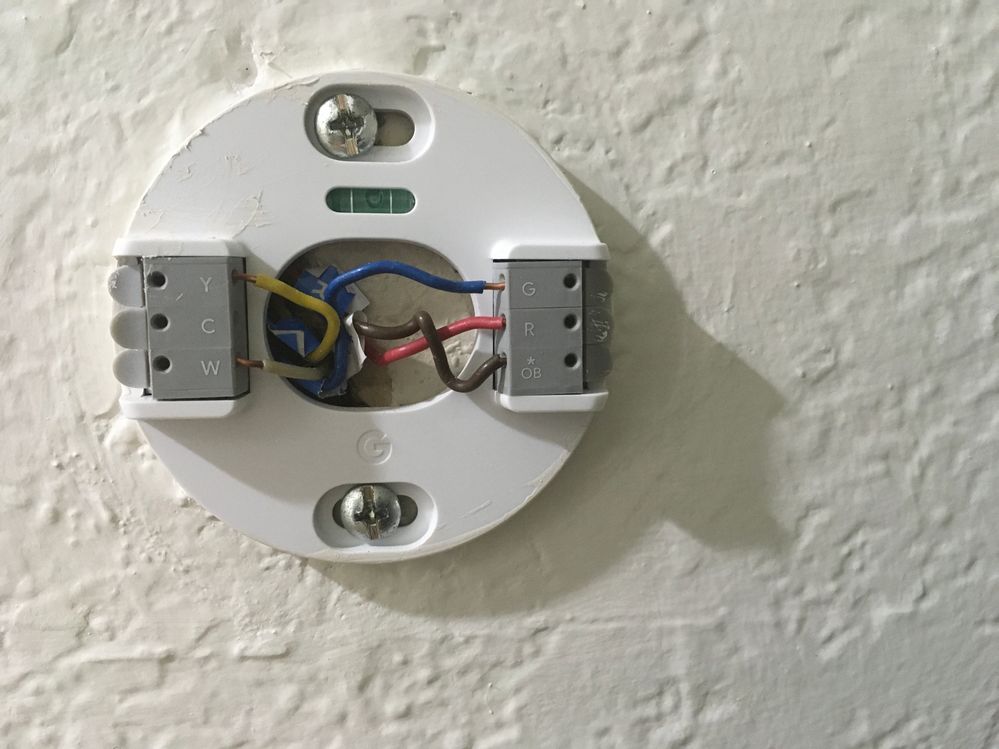

Bryant model 341519-701.  I need to start from scratch because I don’t know the wiring configuration from the previous thermostatimage.jpgimage.jpg
22 REPLIES 22
The wire you have in *OB is to be defined as W2, stage 2 heating. Other than that, all OK.

I clicked on wiring and it asked if I want add or subtract wires. I clicked add and it said add “C” wire?
@Hague , what I would do is on the control board, move the Blue with to join the White wire on C. Then get the green wires not connected and place that the G where the blue wire was.  Nest, at the thermostat, move the blue wire to C and pull the green wire out of the wall and place it on G. Last, turn the power back on.

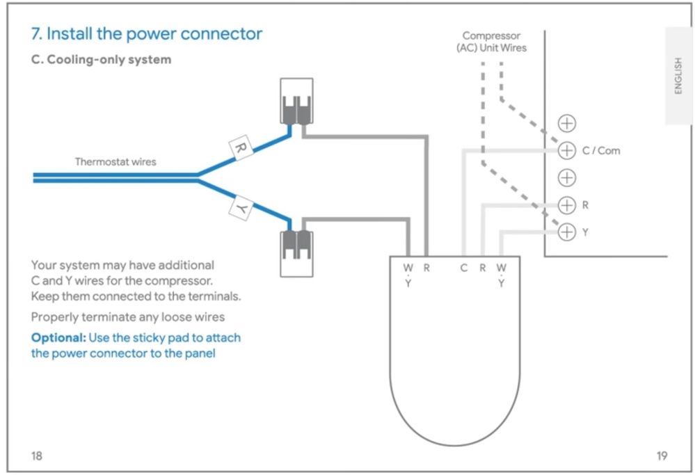

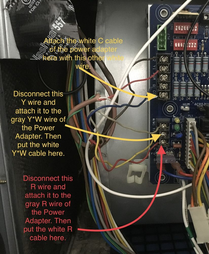

@Hague , here is a picture of the wiring if the Nest Power Adapter using the Y wire.
AC Cooling Wizard
I have connected everything as depicted in the picture and everything seems to be working except when I set the thermostat to HEAT mode and raise the temoerature the fan comes on but the furnace does not light the gas therefore no warm air
Remove your Nest Display, then remove the gray wire from W. Now make sure the bare copper wire is straight, no bends.  Then reinsert the Gray Wire into the W connector as far as it will go in.   Replace the display and test the heat again. Also has a test, you can touch the gray wire to the bare copper of the R wire and hold it there, if the heat comes on, then all is OK with your furnace.  If the heat does not come on, there is a problem with your furnace. If you want to be able to check the furnace, use a metal paper clip and put the red and gray wires in the paper clip.
