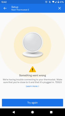

Hello,
We are trying to install our new nest thermostat E - however it will not detect it during setup. We've tried multiple phones, scanning the dot matrix or with the code on the bottom - it won't progress. Is this image normal?

Not that unfortunately - it won't connect through the nest app. I've also tried the Home App (after uninstalling and reinstalling - I still had "Error: unable to start device paring

Thanks for reaching out. After a lot of time with the Google support team we identified that the unit was faulty and Google exchanged it. The new unit went through initialisation with no issues.
