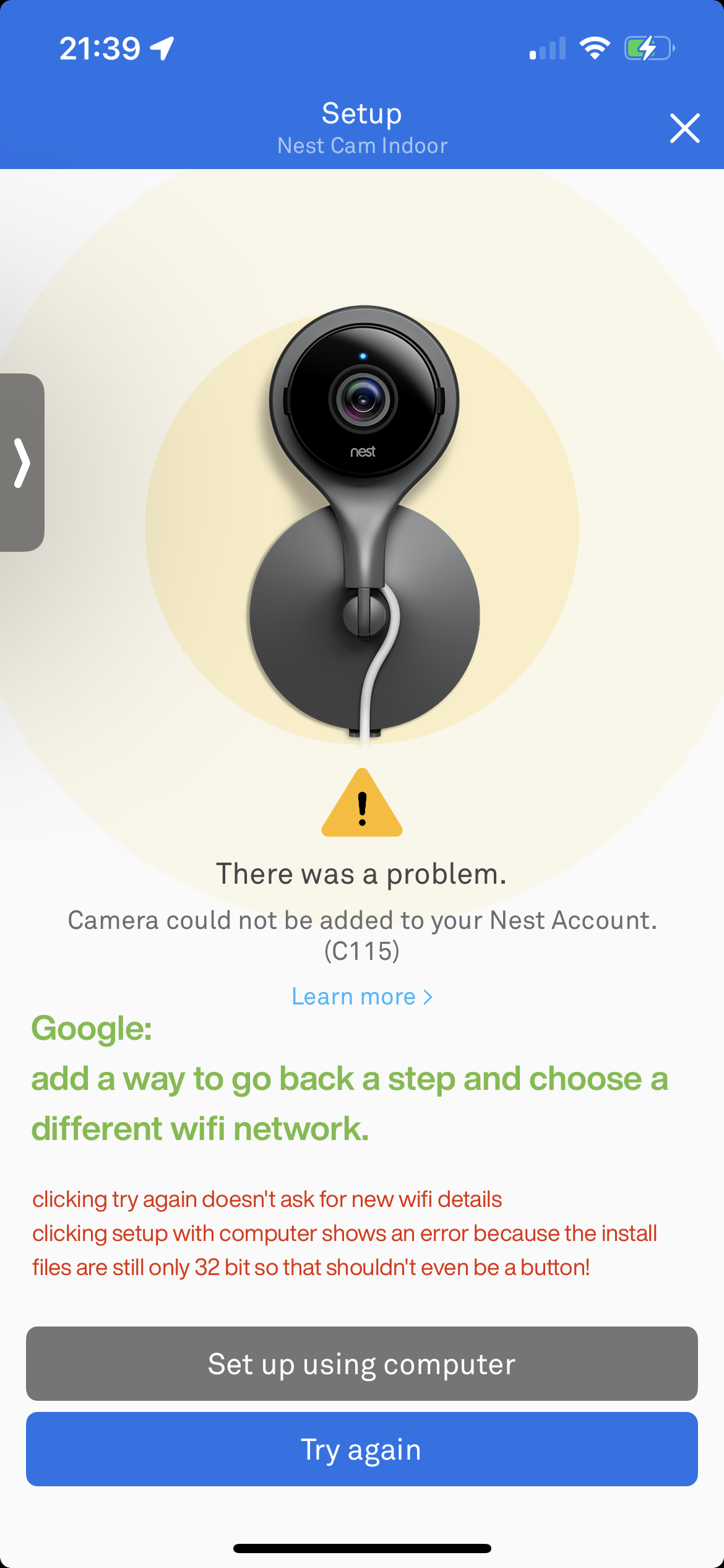

But it's a similar experience when setting up a nest device and it asks you for your wifi password during setup. I first made the mistake of entering the password to the 5Ghz wifi band and it only supports 2.4Ghz.  So setup failed, but instead of asking for a different network and/or password, it just has the option to try again.  Which just retries to connect like before and keeps failing. Even starting the process all over and connecting my device to use the 2.4ghz wifi doesn't work because it skips the part where it asks for a wifi password, and uses the old one causing an infinite loop of device setup failure.
You need to totally forget the 5ghz network in your network settings so that the nest app can't connect and then it asks you for a new password.  Maybe you can try to forget the network your thermostat used to connect to and see if it asks for a new password.  Or setup your new wifi to be the exact same name and password as it previously was.   Nest should really fix these setup issues, creates such a bad experience.
