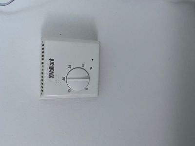

Hello, I would like to buy nest learning thermostat but I am not sure whether it is compatible with my installations (pictures) and if not does somebody now is there some way to make it compatible with some additional component or something?

Hello @AlexD , I am located in EU so I suppose I need Europe model. I am not sure I undestand what is a heat link so I would appreciate if you could clarify additionaly what does it mean.
I have Vaillant Turbotec Pro boiller.
Thank you in advance.
These are boiller and current thermostat

The 3rd Generation Nest Thermostat comes in only one configuration for the European market, and that is the one with the Heat Link. In the second video you can see a thermostat that is destined for the US market. In the first one you can see the Heat Link being wired to the boiler. If you tell me what kind of boiler you have (system / combi) and what fuel does it use, I can tell you if it is compatible with the thermostat or not, but I also sent you the compatibility checker in the previous message.

Thank you very much. I have check and it is compatible 🙂
Basically you explained all I needed to know. This heat link was something I didn’t understood but now all is clear.
I already have this one in basket and I will buy it. The problem was that on Amazon I don’t have on pictures this hear link and it was not clear then. Even in description it says that only thing in the box is thermostat…

Thanks for the response. The Heat Link is a piece of the Thermostat unit that has to be wired to the boiler and it basically acts as the controller. The thermostat will send the signal to the Heat Link, and the Heat Link further to the boiler. From the pictures that you sent us, I suspect that you've done the US compatibility checker, as that one is requesting pictures of the wall thermostat. Please access this link, select "United Kingdom" and proceed to test the compatibility of your system: https://goo.gle/3AF4Aei. Let me know how it went.
