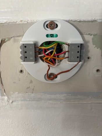

Hi I am installing my nest and have an extra y2 wire. All of the current spots are filled. Can I tape the wire and tuck it in behind and still use the thermostat? Thank you

Unfortunately the forum is telling me that I do not have permission to upload images. Here is the list of wires that I have.
C, R, G, W1, Y1, Y2, W2/OB
the new device has slots for
C, R, G, W, Y, O
I believe that I have 2 stage heating/cooling as often the current thermostat will flash Heat 2 or Cool 2 when it is operating.
Yes it does have a heat pump
dcrser2
Sorry I figured it out. Here are the pictures.

I appreciate you sharing the photos. Based on the images, the Nest Learning Thermostat  (4th generation) appears to be compatible with your system. Since you have two auxiliary  sources to ensure your system performance's expected.  Can be dangerous to your HVAC system only leave a tape the wire and tuck.
