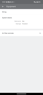

  • What kind of HVAC system do you have? (Heat pump, conventional system, etc.)
    • Heat pump

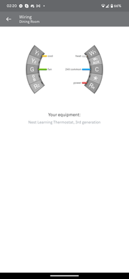

  • Do you have a common ground wire or C wire?
    • Yes

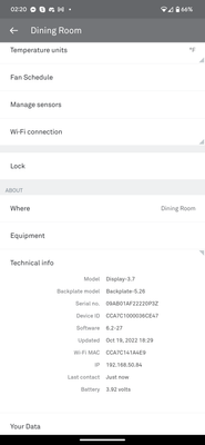

I'd love to know more about this. Could you share a photo of your current thermostat's wiring? Also, please tell us the power readouts (battery level, voc, vin, and lin) on your thermostat's technical info settings, and I'll wait for your response.

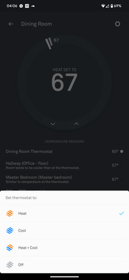

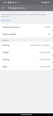

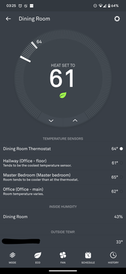

I think I've got some better "proof" I guess. Last night I woke up in the middle of the night because, again, the room got very stuffy and uncomfortable. Obv this kicked me off my sleep and I put my hand above the vent, nothing...
So I started taking bunch of screenshots of the application status:

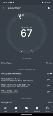

But while I was browsing these settings and taking screenshots, the fan started working:
Then again, the same night about an hour later, similar story. First, the fan was not working when I opened the app:
And then it started working:
My expectation is, that the start time would always be at the 0th minute for each hour. But even if that's not the case, the start time for these 2 instance 1 hour apart are not at the same time.
Thanks for sharing the screenshots, @Batjaa. Big help!
Since you can run the fan independently and only when your thermostat is in a temperature mode (such as Heat, as shown in the screenshot). I'd suggest disabling the Home/Away Assist and turning off the Eco temperatures so it won't automatically change into Eco mode.
Please observe and keep us posted on how it goes.

I woke up last night, again very stuffy and checked my phone. It was 4am, I waited couple minutes to see if the fan would start running but it didn't.
After taking these screenshots I manually run the fan 😕
 This is becoming very annoying.
