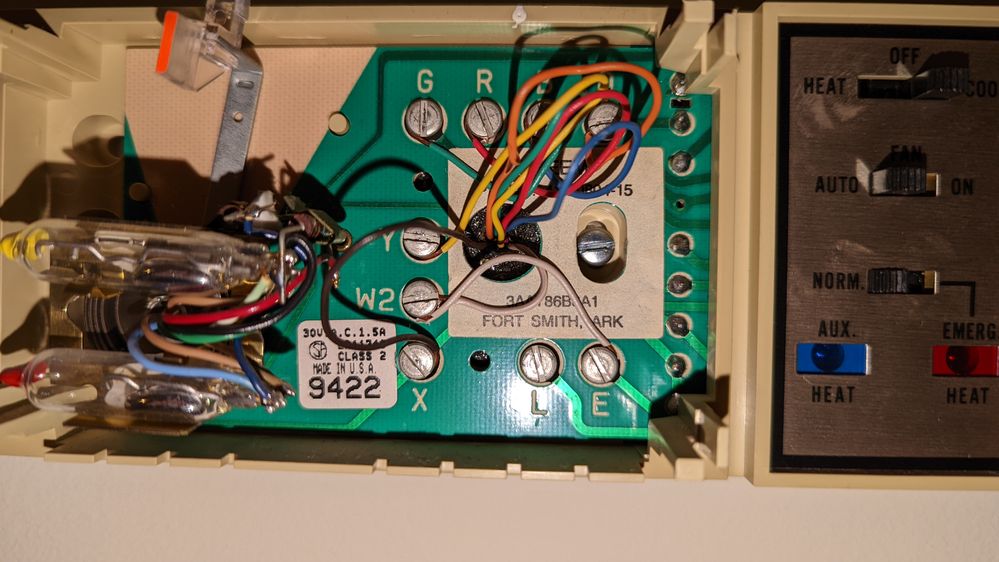

I have a OLD Rheem AC/Heat system that is so old it has mercury switches!  It still all works great and it is used for our upstairs. Please see photos for wiring and info on the system. (Just need better control than mercury!)
When I used the Nest compatibility tool, it says it is not compatible. The reason stated was that it was a proprietary  system. Yet I have seen that others have been able to connect a Rheem system to a Nest Gen 3.

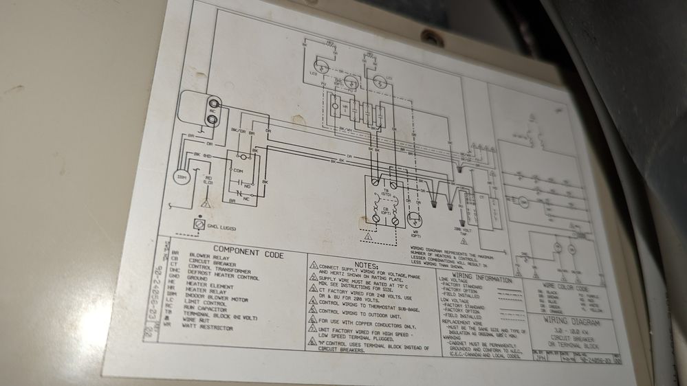

Attached a is a shot of the current wiring and shots of the labels for help in this.
Note that the WHITE wire travels over from W2 to E.
Any help with how I should wire the Nest Gen 3 would be great.  Thank you kindly.

By looking at the photos, it looks like you have a heat pump that could be compatible with Nest Learning Thermostat. I'd like to verify the connection for the W2 and E. Could you take another picture showing a clearer connection for those 2 white wires?

Now getting back to what you had asked.  The WHITE wire comes out of the wall and wraps around W2 and then continues on to E.   I had mentioned that in my post "Note that the WHITE wire travels over from W2 to E."
Hope these 2 photos help.
Thank you again Ryan!  I hope we can get it to work!!!
Give this a try
Brown - X to C
White - W2 to W2/AUX (set as AUX heat)
Yellow - Y to Y1
Green - G to G
Red - R to Rc
Blue - B to OB
Orange - O to (not used)
You will need to make this change on the heat pump orientation.
  1.  On your thermostat, go to Settings.
  2. Select Equipment.
  3. Select Continue > Continue.
  4. Select Heat Pump.
  5. The Nest Thermostat defaults to an O setting for heat
    pumps.
    • If the O option is highlighted, select B.
  6. Test your heating and cooling again to make sure the issue is resolved.
The Orange (O) wire is for a defrost mode which the NEst doesn't support, so just tape it off

Patrick....It works!!!!  This is despite the online NEST compatibility page said it would not! Thank you for your help.  I wired it as you said and also made the setting change mentioned and all seems to work as it should!
