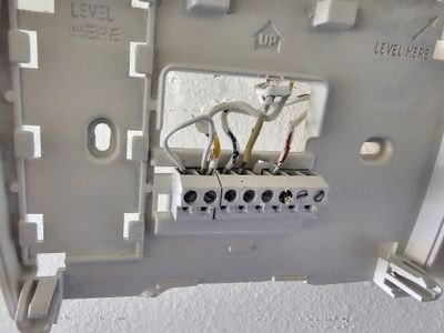

I have the Y,W, G and R wire. The heater works but the AC doesn't turn on. Only turns on the fan when I switch it to Nest

  • Would you mind sharing a picture of your Nest thermostat wiring installation?
