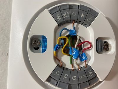

Hi.  I just set up the nest. Removed my old programable thermostat.   Filled previous wiring and now my nest is showing heat pump even though I picked gas forced air.  Any help would be appreciated. Thanks

Sorry.  Followed previous thermostat wiring
@Sunnyw75 ,
can you post the picture you took of the old thermostat wiring before you removed it so we can verify
AC Cooling Wizard
I can’t seem to post a picture
 old one
 nest
Sunnyw75
@CoolingWizard   Pics posted.  Thanks in advance
@Sunnyw75
Move the white wire to W1. It should have bern placed in OB
AC Cooling Wizard
Sunnyw75
Your saying move the white out of ob and put in w1? Correct
Yes. Remove the white white from OB and insert it into W1.
