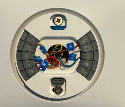

Thank you for the information and following up with me. It was happening every 2-3 days When I had the thermostat set at 70 or higher, it’s only happening once or twice a week now that I have the temperature set lower between 65 and 68. I haven’t noticed anything common when The heat decides to not shut off and keep running, like sometimes it’s during the day and sometimes it’s at night. Let me know if there’s any other information I can pull from the unit to share with you. In another comment, I shared the pictures of the prior thermostat and the new wiring to the nest if that is helpful. Thanks again! Jason

Hello Pompeyjas0420,
I appreciate you keeping me in the loop. To continue providing you with further information, could you please attach a picture of the wiring configuration in the Nest Learning Thermostat 3rd Gen?
Keep me posted so I can provide you with further assistance.
Daniel
Hi there, thank you for the reply. Here is a photo of the nest wiring. Thank you for your assistance. @moralesvicente
@Pompeyjas0420 ,
You have a heat pump and your old thermostat had the brown wire attached to EMERGENCY HEAT. You need to move the brown wire from W1 and place in the programable * terminal. Then need to configure that as Emergency Heat. I am not saying this will fix your runaway heat problem but will correct the software thinking you have might have  a duel fuel system.
