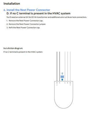

Any Nest thermostat will work, but you must use the Google Nest Power Connector and possibly a relay.
Give this a try.
