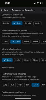

These are the settings.  I adjusted yesterday. Do these make sense ?
@H20_goals ,
that all looks fine I would just let you know that most HVAC systems need to run about 15 minutes to reach their peak efficiency before a technician will measure its performance
