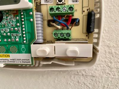

I'm sorry for the late reply, and thanks for trying, @jacksonland. The labels on your thermostat might have been blocked by the wires in the terminals. Could you at least please tell us which terminals and what color of wires are connected to your thermostat?

The top terminal, has 4 connections, left to right.
The first top terminal screw has a blue wire that connects to the the third screw of a bottom terminal below it (which has three screws).
The second top screw has a red wire that connects to the fourth screw of the same top terminal.
The fourth top screw also connects to the first screw of the bottom terminal.
A white wire from the wall connects the the bottom terminal second screw.
A blue wire from the wall connects to the bottom terminal third screw.
Thank you for any help.
Bill

Hello there,
Thanks for sharing the photo and how the wires are being labeled. It appears that you have two jumper wires connected on both heating and cooling ports and no power wire on the R terminal. With this, your system might need to be rewired by a professional installer to be compatible with the Nest thermostats.
