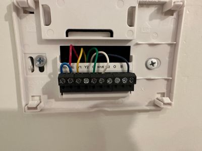

Is this wiring compatible?
broffe18
Is my wiring compatible? Thank you!
@broffe18
Yes, your current thermostat is compatible with the Google Nest Thermostat and the other two.
Try this wiring
Red - Rc to R
Yellow - Y1 to Y
Green - G to G
White - W1/E to W
Blue (Black?) C to C

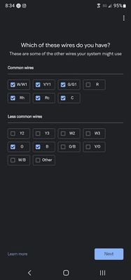

When asked which wire you have, select.
W/W1, Y/Y1, G/G1,R, and C
Thank you so much!

This is perfect! Thanks for sharing a wiring and setup guide, @Patrick_Caezza.
@broffe18, how's it going? Have you managed to install your new Nest Thermostat? Please make sure to follow the wiring configuration mentioned above and ensure that you also properly configure it in the app. If asked, choose these options: W/W1, Y/Y1, G/G1, R, and C.
Let us know if you have more questions.

Yep, worked perfectly!
Hi broffe18,
Awesome! I'm glad to know it's up and running. It looks like we can consider this one complete, so I will lock the thread within 24 hours unless I can help out with anything else.
