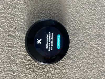

Hi there @rvhaeften! I'm really sorry to hear about this situation, but I'll be more than happy to assist you and find a resolution. Could you please tell me more about the issue? Do you see any lights on the Heat Link?
rvhaeften
Yes a yellow light I get the n80 error the heatlink wil not connect anymore

Understood. Let us have a quick look at the power readings, just to make sure that there's nothing going on there. See if after the message you are able to locate the Technical info> Power option. If you are able to access it, take a quick picture of the power readings.
rvhaeften
AlexD
Thanks. The power looks good so that should not be a problem. You mentioned you did have to deal with a few replacements in the past. Would it be possible that the cover on the Heat Link might have gotten switched with another? While rare, if you are comfortable in doing so, you can turn off the power to the Heat Link and take the cover off. There should be a pairing key on the inside of the Heat Link body, next to one of the holes for the screws used to mount it on the wall. If it matches the one on the cover, then that is the one but if it is a different one, the one on the Heat Link is the actual key.
