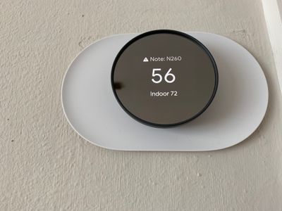

N260 error
Akr2131

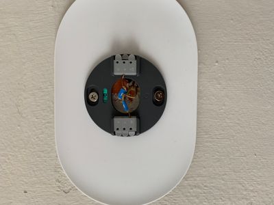

Not sure why, I’m receiving this error. I have turned off and on the relevant breaker. I have also troubleshooted the wiring (will attach photos of before and after wiring). Please help - my home is very cold thank you.

Ashepherdson
It's saying it isn't getting enough power.. a C wire or nest power adaptor is needed for your setup

David_K
To add to Ashepherdson's great advice, you can find more information on this and next steps in the help centre article below.
