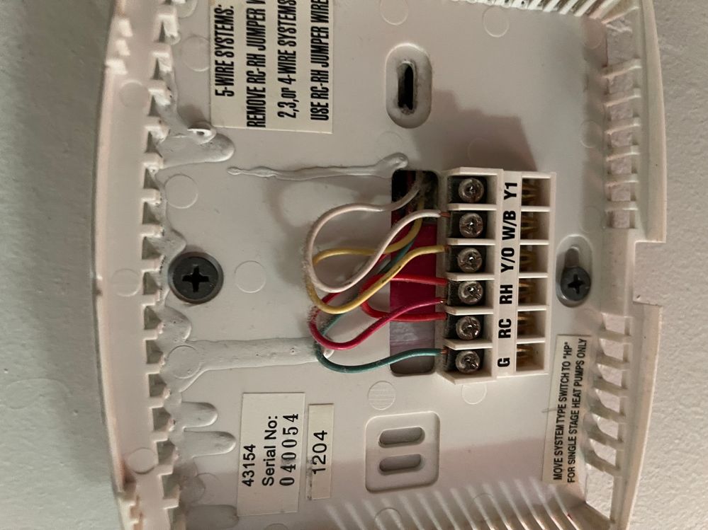

I'm looking to upgrade my thermostat from something from 2000 to the nest. Can someone help me determine which wires go to which wires???IMG-1425.jpg

Thanks for reaching out. If you have conventional heating and cooling, you could follow the wiring below:
  • Yellow wire to Y1
  • Green wire to G
  • Red wire to RC or RH
  • White wire to W1
Let us know how it goes.

Thank you so much! My question is what is the difference between the RC and RH?
EdwardT
Hi Briyun,
Thanks for the response. The 2 R wires are for systems with dual transformers. We use the RC for the power wire of the cooling, and the RH terminal for the heating.
