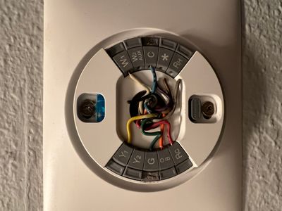

  • Please send me a picture of your current wiring installation.

(Trying to figure out how to add the picture)

The simple issue (no C wire) doesn't appear to be the problem.
Has this problem been there since it was installed?
Any chance that you can post a picture of the control board terminal block in the furnace/air handler?
@GrantV
Can you post a picture showing how the Nest base is wired?
