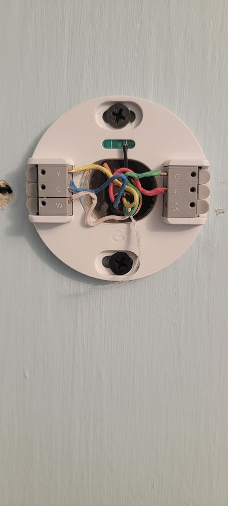

DrZCharlie
I just did an install of my Nest Thermostat. I initially had problems with the E-294 code and sought help with an online nest specialist.  We managed to clear the code by moving the white wire from terminal o/b originally wired on my old Honeywell Thermostat (see photos) to the W terminal on the Nest.
All seemed well and we went to bed thinking that the thermostat was functioning properly.  However the following problems were noted:
1. About 1 am I woke up cold and investigated, while set in 'Sleep Mode'  units fan runs without the furnace burner engaging resulting in a very cold house.
2. After coming out of 'Sleep Mode" and into 'Comfort Mode' the furnace and fan both run, but when the thermostat demands heat, the fan comes on for about 10 seconds along with the pilot light and then shuts off,
3. Once the pilot lights the burner, the fan comes back on and runs normally until the thermostat is satisfied.
As an aside, the old thermostat had a jumper that ran between R and Rc, I am not sure that matters for this discussion but wanted to throw it out there.
Can anyone shed light these problems?
Goodman AC and Gas Furnace PKGGoodman AC and Gas Furnace PKGWiring for Thermostats old vs newWiring for Thermostats old vs newOld Honeywell ThermostatOld Honeywell Thermostat
New Nest Thermostat WiringNew Nest Thermostat Wiring
