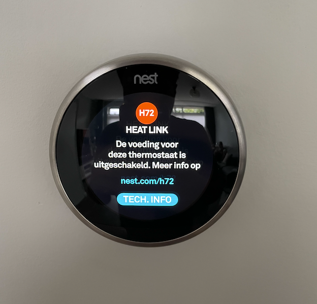

Situatie:
- Google Nest Thermostat V3 show error message (see attachment)
- Heat link has no light on (green/yellow/blue)
I have turned off the power to the Heat Link for a few minutes and then turn it back on.
Unfortunately the Nest thermosstaat shows the same error message.

4. Did you notice any message on the thermostat display?
Yes H72 - Heat Link error, see attachment

@DragosC , @AndaD
Sorry voor de late reply, Our baby was born last Saturday.
Below you will find answers to your questions. some I already answered in the original post
Are there any lights on the Heat Link?
No, no lights
Does the boiler activate when calling for heat by pressing the Heat Link's button to activate Manual Mode?
No, thinking happens. Fortunately, hot and cold water through the taps works. No problems with the boiler.
Are you seeing any wiring report or error on the thermostat and/or the app?
Yes H72, see picture in the first post
