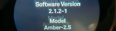

What model do you have?
 this is the version.

My thermostat is up to date 5.9.5-2

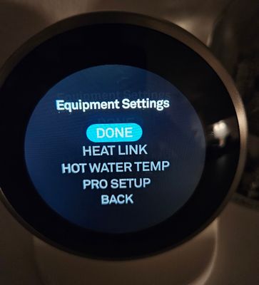

I don't have option to see the bacteria option
You don’t have the option!!
Have you looked in the settings - Equipment  - Bacteria ??

I don't have such az option
What is the hot water temp, have you found anything there that might solve your issue?
Just the water temp, for the tap water.
That’s a new one on me! Where you have water temp it’s usually Bacteria! Can you disable that? Perhaps even raise or lower the temperature. That could be the problem if the setting is too high or to low.

Mods the user needs help with this setting, is this normal for a display to have Hot Water Temp instead of bacteria?
NO 😞 and i think that is the problem
I'm familiar with UK thermostats, and to be honest didn't think they were any different from Europe. I don't have that Hot water, we have Bacteria. Let's see if one of the mods can help
I think they are the same, connected via Heat Link.

Yes they are the same, but it’s that Water Temp I have not seen before. Can you try and factory reset again. That might alter something in the setup.
I assume you set the thermostat up as a Combi boiler?
You can alter that setting in Equipment - Pro setup, but I would probably do full factory reset to confirm everything is correct.
