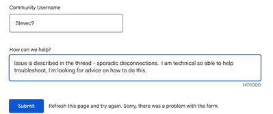

Stevec9
Hi Jonatham,
That link isn't working for me, I get this error:
Looking at the raw response in Chrome DevTools I see this
"submit_error": [
            "code": 22,
            "sub_code": 4,
            "escalation_rpc_event_id": "62E8480261264.5630F70.B516518E"
            "code": 6,
            "error": "CUF Submit Pv2.CreateEmailCase:FAILED;hc:googlenest;form:nest_community;rw:11103743;u:534094234082;code:9;error:com.google.apps.framework.request.StatusException: \u003ceye3 title='FAILED_PRECONDITION'/\u003e generic::FAILED_PRECONDITION: The request is ineligible. Follow go/case-creation#eligibility to resolve."
Seems like my "request is ineligible" ??
Thanks again
Steve
sicsacol
Hi @Stevec9,
Thanks for the update.
I'm sorry to hear the link didn't work. No worries, please try this form. We're experiencing an issue with the regular form link, so this alternative link is from the Pixel Watch team. However, once we receive your form, we'll redirect it to the Thermostat team. Please provide the requested information (community username and thread link).
Let me know when you’re finished.
Jonathan
Stevec9
Done - thanks
