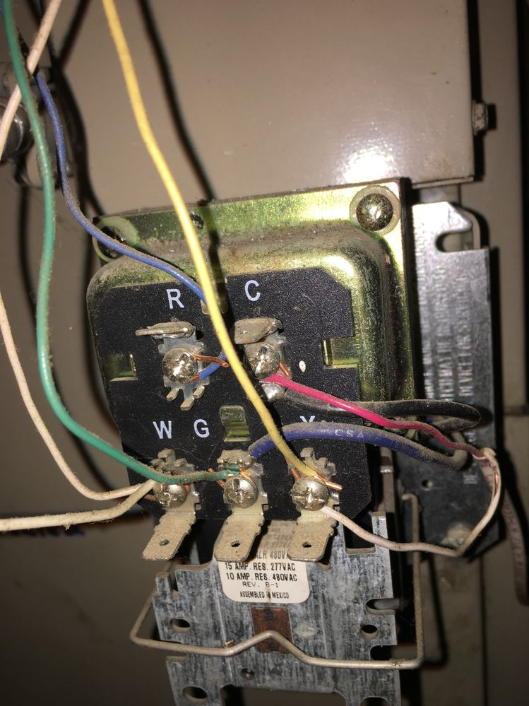

garth48
I don't know if this helps, but here's an image of my setup.  Just did this on Saturday.  I know that the Y1 is "redded" out, but that's for AC and I live in PA...so cold right now.  The Rc is also greyed out, so I'm not sure what's going on there.  My AC and Heat all patch into the same transformer, but my C terminal on the Transformer doesn't have a wire out.  The blue wire out of the transformer comes off of the R terminal.  So I can't figure **bleep** out...
All that said.  Heat works, I get the following on the power read out on the thermostat (all are within workable levels, though obviously it's not picking up a C wire power feed)
Battery 3.84
Voc. 35.87
Vin 34.80
lin 40mA
On the heater (my red wire to thermostat comes off the oil burner igniter)On the heater (my red wire to thermostat comes off the oil burner igniter)One of those Rh or Rc is actually blue (see transformer)One of those Rh or Rc is actually blue (see transformer):
