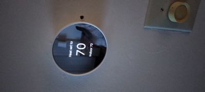

OK I don't have a picture of original wiring, but here is the current wiring diagram, all I did was add the"C" wire but did not change it in the device as in telling the device that there are now 5 wires. Hmmm I don't have permission to upload files
mrelmo
OK here are the images
luciaaa
Hi, @mrelmo,
Thank you for your prompt response and the information you provided. I'm happy to assist you further.
To add the C wire during the setup process, I recommend performing a factory reset on your Nest Thermostat and setting it up again. During setup, you'll see the option to select the wires; please choose them in the following order: W/W1, Y/Y1, G/G1, R, and C.
