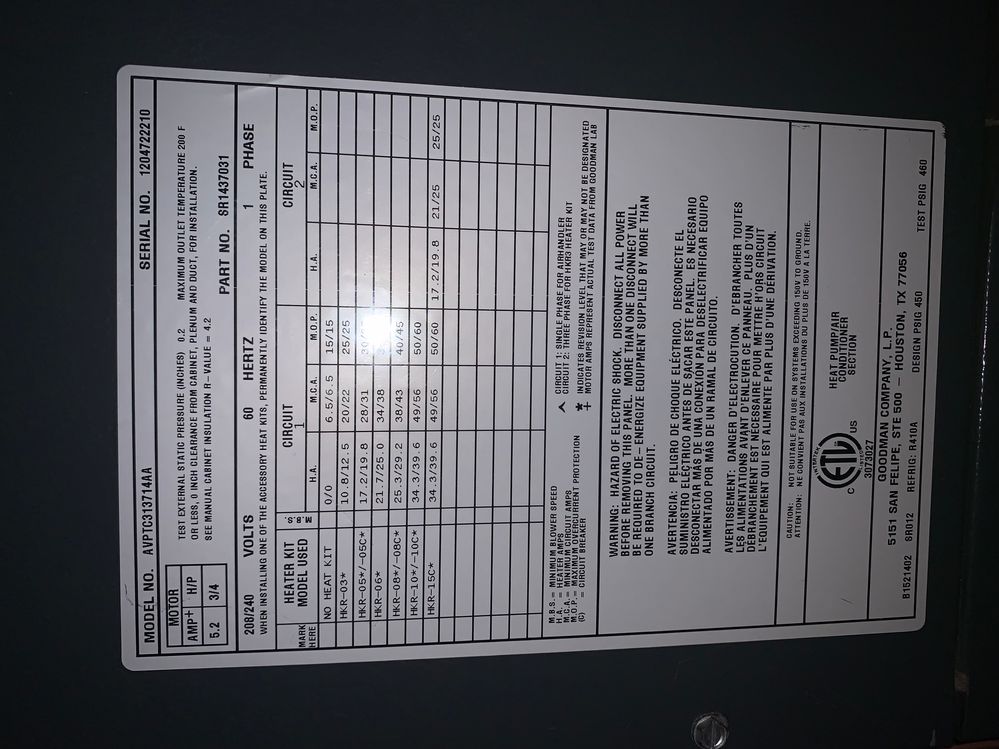

Hi - I moved into a house with a Nest mirror white thermostat. All the wiring was done and I believe everything worked ok for the previous owner. I then did a factory reset (probably a mistake...) and paired it with the app.
Now I don't think I have things setup correctly. It heats when it should cool, and cools when it heats and it is generally very erratic.
My system is an electric heat pump that provides both heating and cooling through forced air. That is the only system.
I attach photos of the wiring and the heat pump unit. I have Y, C, W, G, R, OB* [Actually I can't see how to upload photos]

Hi - thanks for the replies. I'm not sure if these photos are useful in diagnosing the situation.

Thankyou for this reply. I followed all the steps. I've tried the heating cycle and it is blowing cold.
See attached for the wiring setup with B instead of O.
