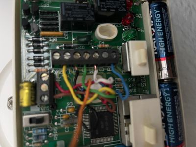

 this is initial wiring, the temp is 76 says will be 72 in 2 hours… temp has not moved…
if reinstall old thermostat, cooling works

How did you wire the Nest?
I can't read the terminal block labels.

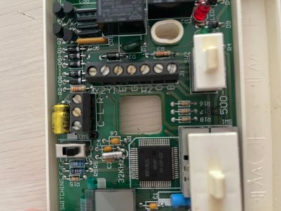

Martina010507
Here’s the labels without wires
Give this wiring a try,
Brown - C to C
Red - R to Rc
Yellow - Y1 to Y1
Black - E to * (set as Emergency heat)
Green - G to G
White - W2 to W2/AUX (set as AUX heat)
Blue - B to OB
  1.  On your thermostat, go to Settings.
  2. Select Equipment.
  3. Select Continue > Continue.
  4. Select Heat Pump.
  5. The Nest Thermostat defaults to an O setting for heat
    pumps.
    • If the O option is highlighted, select B.
    • If the B option is highlighted, select O.
  6. Test your heating and cooling again to make sure the issue is resolved.
