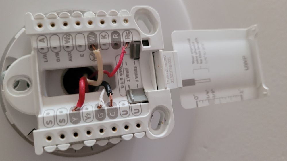

Looking for advise on wring issue. I have a Honeywell thermostat working perfectly fine that i want to upgrade to Nest 4th Gen Thermostat. I used the same wiring as for Honeywell:
Honeywell - Nest Thermostat
Y - Y1
G - G
C - C
W - W1
RC - RC or RH
I get Error448 stating no power on RC, same error when i use RH instead. spoke with Google chat assistant. Also tried with charging nest thermostat panel for 8 hours. nothing could solve the issue yet. i have attached link for photos of Honeywell and Nest wiring for reference. Looking for suggestions.

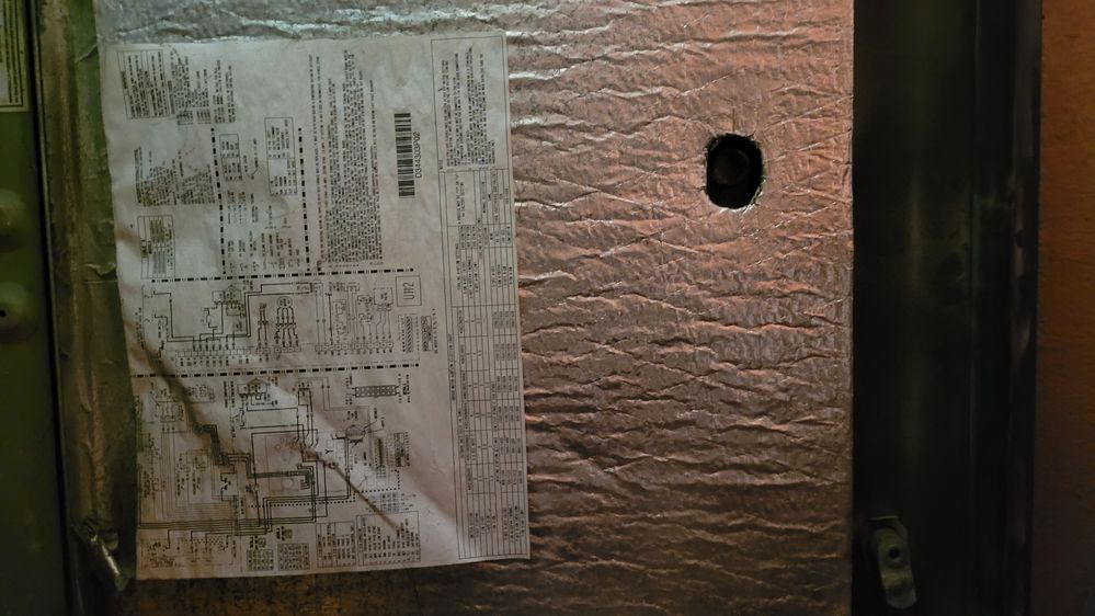

Are there two separate cables going to the thermostat?
Take a look in the furnace/air handler and verify how the cables are terminated there. Post a picture.
20250906_140252.jpg@Patrick_Caezza Hello Patrick, here are the photos. i am not well versed with wirings. I got all the photos i found on the furnace/air handler. thanks your help. 🙂
20250906_140233.jpg20250906_140116.jpg20250906_140151.jpg20250906_140142.jpg20250906_140134.jpg20250906_140124.jpg20250906_140018.jpg
