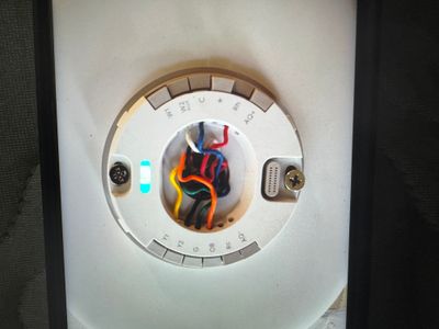

  • Would you mind sharing a picture of your current installation on the Nest thermostat?

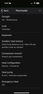

Since you've mentioned that you have a heat pump system, it seems like the inconvenience is related to the reverse valve activation being likely set to seasonal instead of cyclical. For guided instructions, you can check out this article: Troubleshoot when heating and cooling won't turn off. If the heat pump doesn't work correctly after a few minutes, perform a diagnostic test on the thermostat. For instructions, refer to this article: Troubleshoot heat pump issues.

  • Would you mind sharing a picture of your current installation on the Nest thermostat? Yes, please see attached pictures. IMG_1023.jpeg

I appreciate the pictures and information you've provided. It seems the heat pump is set to 'seasonal' instead of 'cyclical' for reverse valve activation in the Google Home app. To confirm, have you tried changing this setting using the instructions in the previous article and the steps outlined above?
In addition, if the system keeps continuously running, please try removing the thermostat's display from the base to see if it turns off.
