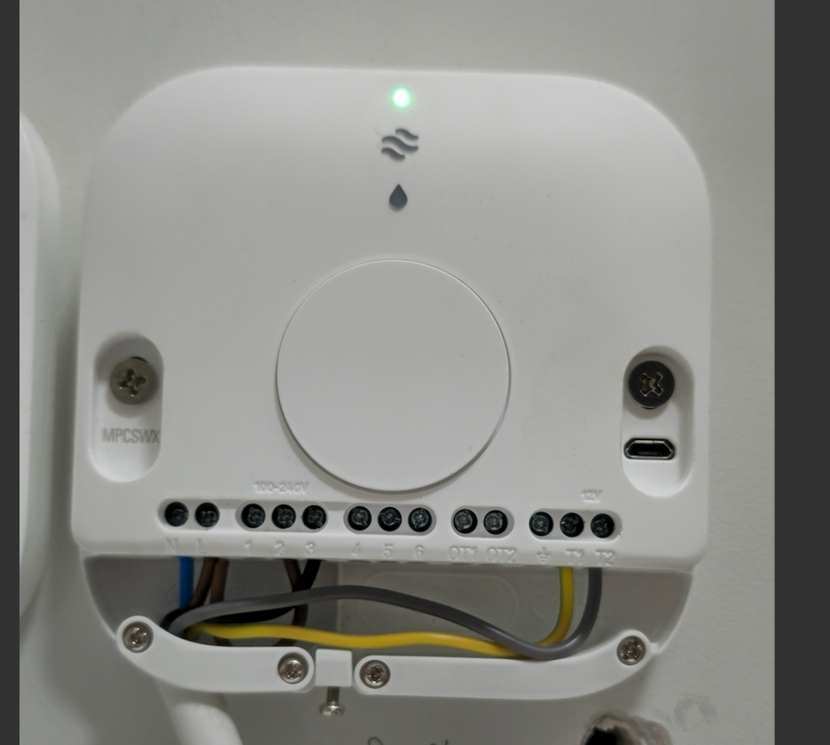

Can you upload a picture of the connections at the Heat Link?

Apologies for the late response - needed some time to take the photo for this.Attaching photo as requested.

The connections answer your question, you have no wiring in the H/W section.

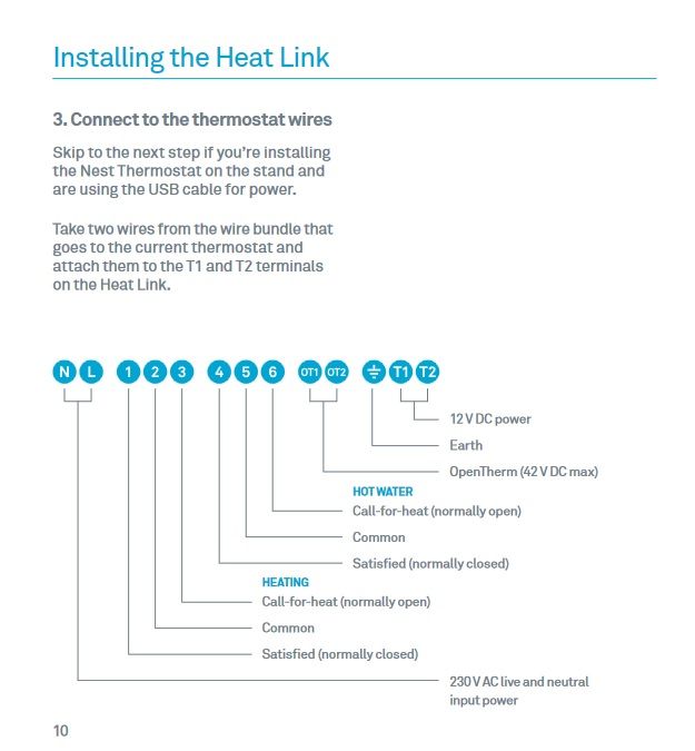

The reason for the app not turning on, it sends a signal to the Heat Link H/W relay, and that's not connected. Manual will turn the boiler on, and if a system boiler will heat the water. See the the picture taken from your handbook that comes with the thermostat, and that should explain it all.

Thank you so much for the help on this. You are right. Those terminals have not been connected to anything and electrician assumed something else.
