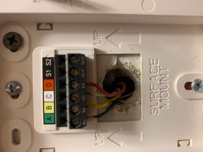

Could really use some help. Replaced my thermostat with the Nest learning thermostat - got it to connect but the fan  would never run. resulting in no AC or heat to work
Now the WiFi is disconnected and I can’t do anything.
It looks like your original thermostat uses a proprietary interface that is not compatible with any Nest thermostat.

Tina12, I'm chiming in to check if everything is covered here. As was mentioned above, your system as indicated on the wire labels is not compatible with our Nest thermostats. You may check this link for more information: https://bit.ly/2KOTqgW
