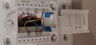

So here's the short. Bought a house last year, heat worked perfect for the winter and ac worked perfect for the summer. Now that it's fall again the heat didn't want to work at first but cooling did. Now it's flipped and heat works but no cold air just the fan running. I've tried troubleshooting switching the o/b settings, reset system, reset nest and nothing seems to help. I have the previous wiring from old unit and have double checked current wiring for nest. I don't know how to cool my house at this point.

Ended up being a burnt wire to the condenser. 5 minute fix, my normal heat wasn't working either it was only aux heat and emergency but all is good now.

Everything is fixed now it was the common blue wire going to the condenser but not the common blue wire to the thermostat that was the issue. 5 minute fix
