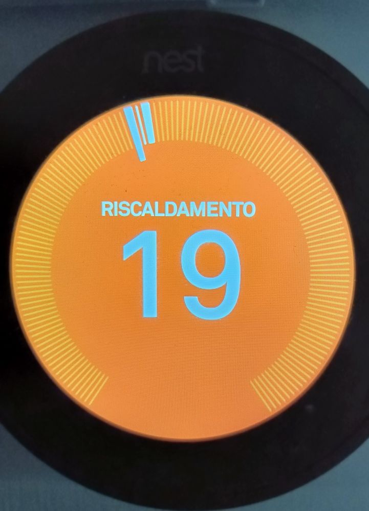

Some time ago I post an Issue: my thermostat started and stopped several time during the day, more than 20 times per day.
So I posted my question to solve the situation.
Maybe something was done in the algorytm of the thermostat, but now the situation is as shown in the picture:
I set 19°C for the temperature and the thermostat remains ON more than 19°C as you can see.
I cannot understand why I have this situation and I cannot understand why is so difficult to set an HYSTERESIS in the program.
If I don't select the AUTO-PROGRAMMATION in the NEST SENSE MENU, thermostat contniue doing what he wants...
The easiest way to use the thermostat is to follow the temperature, give the opportunity to the user to set an HYSTERESIS (from 0.1 - to 1.0°C for example) then the thermostat stops the boiler at the set temperature, remain stoppet since HYSTERESIS and restarts again when TEMP SET - HYSTERESIS SET is reached.
In this situation boiler remains running more than the temperature set and I cannot understand why...
Another thing: PLEASE, make more visible the indicated temperature and the temperature set in the thermostat and in the app too...
In this way the temperature set is too approximative...
Thanks a lot and I hope that this issue could be solved.

By the way, I set 19°C, I don't know how long it remain switched on, but I found that it switches off when temperature is, more or less, 0,3-0,4°C greater than the set.

The thermostat does not turn off directly. As you noted it goes by a slight increment over like 0.3 degrees. The thermostat display and app only shows increments of 0.5 degrees and it will round any temperature to those values. The location where you can see the exact temperature is under Settings> Technical info> Sensors on the thermostat.
It is designed this way to prevent the system from short cycling if the temperature drops slightly more quickly. So 19 would be reached but then would drop under it soon after causing the system to turn on and off repeatedly. This is why a threshold of 0.3, 0.4 degrees needs to occur for the thermostat to react, to turn on or off.
I am sorry for any confusion caused and hope this information helps. To clarify, your thermostat is working as expected.
