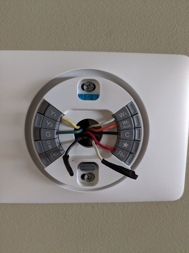

There's a faint buzzing sound after I connect the R wire to Rh for the learning thermostat. Like others suggested, I tried to clean the wire and the connector but the faint buzzing is still around after. Any other suggestions? Thanks

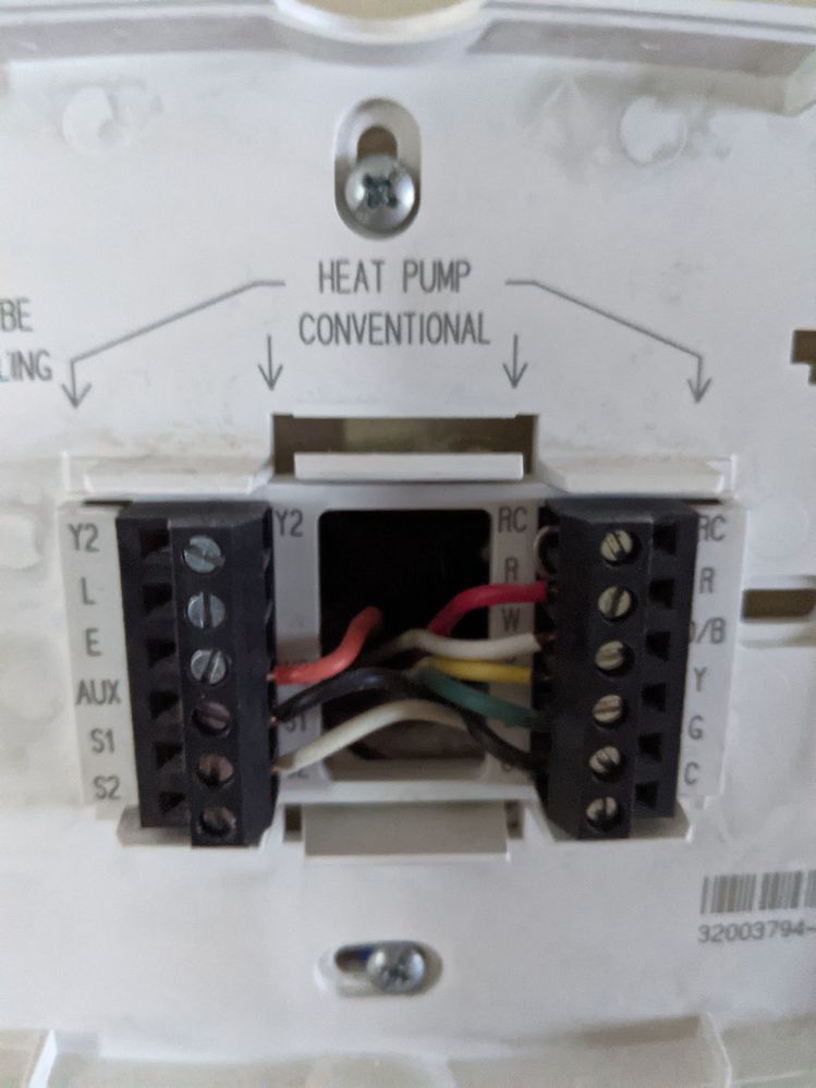

This is most likely a power-related issue that is causing this. To better check this, please share with us a picture of your old thermostat and the Nest Thermostat's wiring setup. Also, gather the power readouts in the Technical Info settings on your actual thermostat's settings and check for any wiring reports in the Equipment settings.
old thermostatold thermostatCurrent setupCurrent setupPrevious setupPrevious setupHi Markjosephp,
Thanks for your response. Yes I agree that this is likely a power-related issue as well. I have uploaded the pictures here. I have yet to do the power readouts out of the nest thermostat but will provide that info here once I get to it.

@Felixyu1988, thanks for the information. I see that you connected the thermostat wires to the Nest Learning Thermostat base correctly. In that case, gather the power readings of your thermostat by going to Settings > Technical Info > Power (Battery, VOC, VIN, and lIN) so we can check if power-sharing causes this.

  • To diagnose possible system maintenance issues, install your old thermostat and test your system. This method is useful to determine if there’s a maintenance problem with the system or if the system doesn't provide enough power to the thermostat.

  1. Double-check that all wires are in the correct terminals. Use the thermostat wiring diagram and the picture of the previous thermostat’s wire setup as a guide.

Thanks for the recommendations. I've tried Option 1 and 3 but unfortunately the buzzing sound still exists. I can't try Option 2 as I don't have my previous thermostat anymore but I do remember that the honeywell thermostat did not have the buzzing sound.
