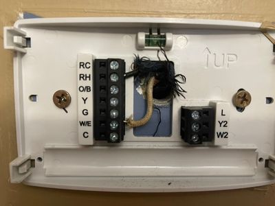

Good morning! Posting a photo of my existing system as was directed by the website. Is it compatible? Also can it be wired directly to a power source so I do not
Good morning!! Posting a photo of my existing system as was directed by the website. Is this compatible? Also can it be wired directly to a power source so I do not have to use batteries?
Please let me know.
thanks in advance!

Thanks for reaching out, and I appreciate you posting your thermostat wiring diagram. I'd be happy to take a look into this for you.
According to the diagram, it will work with the Nest Learning Thermostat and will be powered by your system wires. You can also check your system’s compatibility before purchasing a Nest Thermostat with our online compatibility checker.

Thanks for getting back to us and letting me know that you already have a Nest Thermostat.
If you have the Nest Thermostat (2020) or the Nest Thermostat E, they're still compatible. However, you might need to install a common wire or a Nest Power Connector to avoid power issues. Please take a look at this article and let us know if you need more help.

also when I try to open the link for the compatibility check it says I don't have access to that service...
Hi Mark,
Thank you for responding. I have a regular Nest, not the learning one. Is that not compatible?
