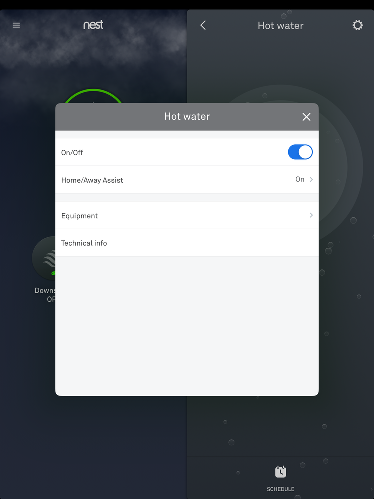

OK, can you tell me which setting you have here.....click the water icon in the app - top right of the screen open settings [the cog icon] - what do you have On/Off set to?
It’s set to ‘On’.
SimonW1
At least I’m assuming that the blue shows that it is switched on. The thermostat on the wall tells me that hot water heating is ‘ensbled’.
