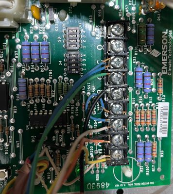

im hoping someone could tell me if my nest is compatible with my trane 2 stage furnace.
You have a conventional system so use the inner labels.
Orange - Y2 to */OB (set as 2nd stage cooling)
Red - R to R
White - W1 to W
Yellow - Y to Y
Green - G to G
Blue - B to C
Select these wires in the Google Home App.
W/W1, Y/Y1, G/G1, R, C, and Y2
