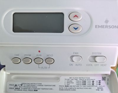

The old thermostat had a slide switch that we manually switched when we wanted the thermostat to control either heat or cool.

Old thermostat face showing slide selector for heat and AC
